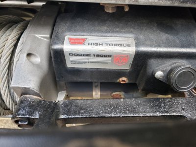

Proud new owner of an 06 2500 Power Wagon. It's got the winch on the front but it doesn't have the controller. Could someone help me identify what controller I need? Attached the winch picture.

I believe this is the Mopar part number for the stock winch controller with the low voltage interrupt...
5161063AD

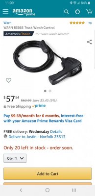

Just in case anyone comes across this question like me in the future, the part is 83665 according to Warn customer service. The connector is shaped like a "D" but will still fit your circle receptacle.
