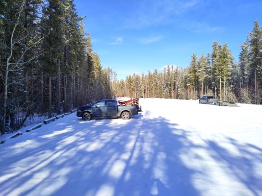

Yes, 21. They still do what they're supposed to, no complaints.
I wouldn't go any firmer than this. My last 2 trucks were both 1 tons. I don't want anywhere near that level of suspension or ride.
700lbs of quad still sits and rides where it should.
