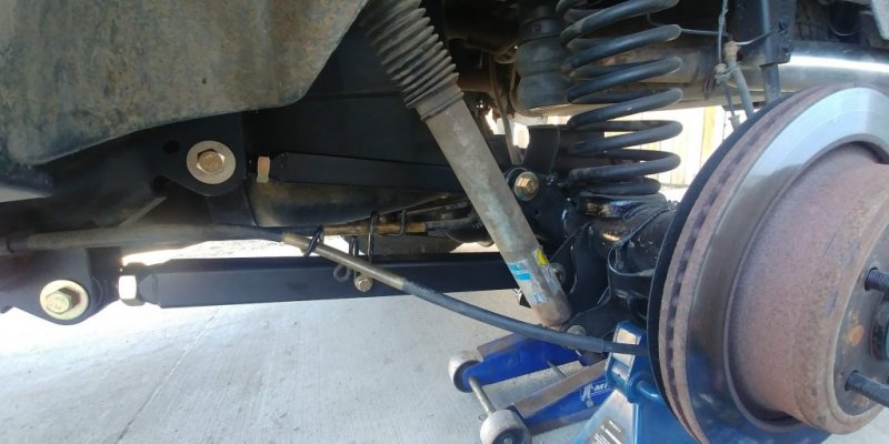

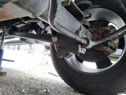

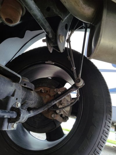

1211 on the left, stock on the right. 17mm coil thickness vs. 15.5mm. Stock truck sits at the same ride height. 45 min install.
star_deceiver
May 18, 2019
878
1,850
Airdrie, Alberta
3.6 Pentastar
Block front wheels. Bottle jack under frame, lift several inches. Remove bottom shock bolt with impact. Jack until brake line becomes almost tight. Grab spring and pull out. New spring in. Lower bottle jack while positioning spring. Insert and tighten bottom shock bolt with impact. Lower bottle jack completely. Move to other side and repeat.
You need your bottle jack, impact, socket and wrench. That's it.IMG_20220525_161522.jpgIMG_20220525_161707.jpg

Swaybar also needs to be disconnected if you have the stock swaybar and end links
star_deceiver
May 18, 2019
878
1,850
Airdrie, Alberta
3.6 Pentastar
Nope, never disconnected that. Springs went right past without issue. See pics above for the large gap.
Is the swaybar on the warlock model different?
