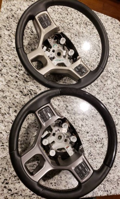

Got my new limited wheel.
Before I tackle this I got to thinking how can I go about d/c ing the battery then rotating the wheel without having the truck running or on?
Do I just he man it? I keep thinking I'll accidently lock the wheel

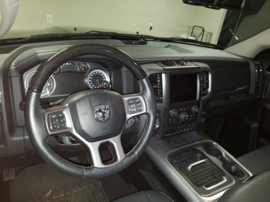

I just put a limited wheel in my Laramie tonight to match the dash/console top I put in previously.
I rented a puller kit from O'Reilly's and had to use an impact wrench to break the nut lose before lifting the front wheels to rotate the wheel for the airbag clips (yes with the battery disconnected). Just be sure to mark the center of the wheel to the hub before pulling and don't spin the clock spring in-between the old wheel and new one.
