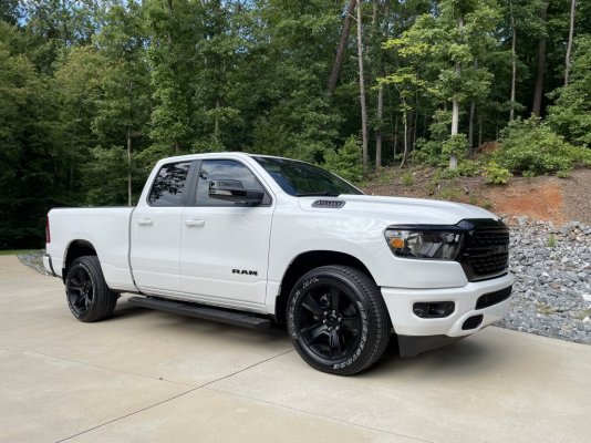

New to the forum. I have a 2022 Ram 1500 Big Horn 4x2 with the 5.7L not lifted or leveled
I have the stock 275/55R20 tires and want to upgrade. Anyone running 275/60R20 tires on stock wheels?
You're only going from a 31.9 AKA 32-in tire to a 33-in tire. All your gaining is a half inch in height. They're going to fit your rims just fine. That's actually the stock size on the 4th gen classics

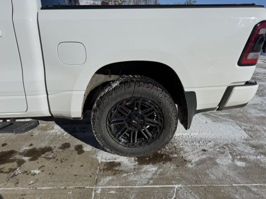

I had 275/60R20 0 offset at at4w without rubbing just little mud splash that I dont like it. Planning to use my old stock wheel with at4w next winter.Running Ram 1500 sports 2023 e torque. Any one running stock wheel and at4w w/out rubbing?
