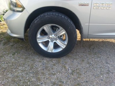

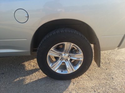

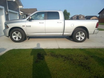

Hey All,
New to this forum, I myself was researching quite a bit find out the tire size that would fit my truck. Seen a lot people asking if these sizes will fit.
Originally was just gonna go with a 285/60/R20, but cooper doesn't make that size in a 20. So ended up with , so have a look let me know what you think.
275/65/R20 Cooper AT3
Specs:
Tire Size:LT275/65R20
Service Description:126\123S
Load Range : E
Section Width: 11.1
Overall Diameter: 34.21
Tread Width: 8.9
Max Load: 3750
Tread Depth: 16

Looks good. Ive been looking at getting that same tire in the same size. How do you like them so far?

With the stock setup, I had the 275/60/r20 on the week before because the dealership put on the wrong tire, and they seemed too small on that size, this size I love.
That extra 1.2 on the diameter made it just right, and the tread depth increased from 12.5 to 16, and the load cap by almost a 1071 lbs
