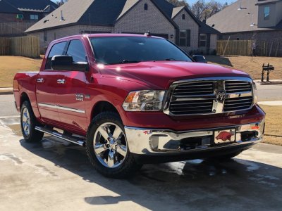

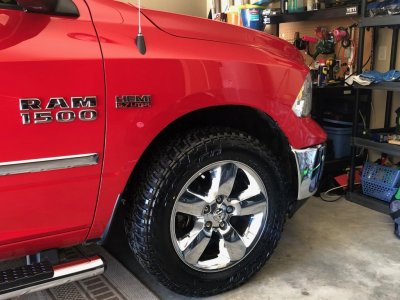

Full Stock 275/60's here.. Next step is Bilstein @2.8 with the 275/65! IMG_2501.jpegIMG_2500.jpeg
