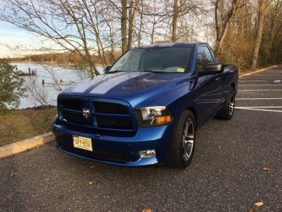

IMG_0122.JPG Has anyone swapped gears from 3.55 Limited slip to 4.10 OEM gears? Just wondering what gears to go with 4.10 or 4.56 gears. I only drive the truck on the weekends and its just for fun. Have a work truck for daily driving. Last time i went to the track with the stock gears and stock trans it ran 13.493. Hoping to get it into the 12's with the trans from L&M and maybe a gear swap. Any thoughts

BYW, that's a sharp truck! I like th blacked out grill and black mirrors.
417 hp..... I think I'd turn that up a bit.
But do gears!
