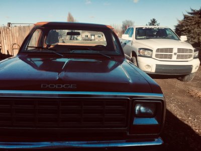

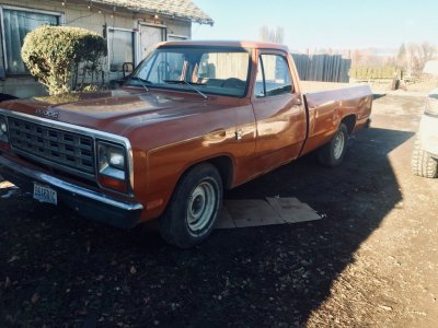

Hey guys new to the group and couldn’t find a post with info I’m looking for
Just picked up an ‘81 d150 with the slant six and manual trans with the intentions of making it a project, I have a buddy that has a 440 he’ll give to me and was wondering what mounts, bellhousing, and flywheel will I need to make this work along with other things I’ll need thanks in advance
