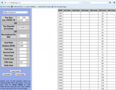

Yes, you have 3.92 gears if the 0.67 final drive ratio I looked up was correct.

Thanks guys. I did pretty much trust the build sheet. I didn't really trust the used car sticker because it also said manual seat adjusters but I have the 10 way power drivers seat too. So... 3.92s... I think I see a little taller tire in my future when the stockers are done.
