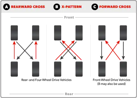

Personally, i have a conversation with the guy at the computer, IF i have concerns.
Like when they do the Tire Rotation, I prefer the Modified X pattern. ( rearward cross )
I stand outside of the BAYS & watch for the tire switch over to the opposite side.
This time of the year, standing outside in Southern California, could be called crazy, it is a touch on the warm side.
Usually a Tire Shop is in a rush & they only do Rear Tire to Front & Front Tire to Rear. ( Straight Rotation )
Their short cut pattern, would always keep the Right Side Tires on the Right & the Left Side would always be on the Left.
That works well if the Tires have an Directional ARROW on the Sidewall of the tire & possibly back when the tires were still 'Bias Ply' tires, ( before Radials )
Straight rotation was developed in the early years of radial tires. This rotation method switches the tires front-to-rear but does not cross side to side. This rotation method is used for directional tread patterns.
What is the proper tire rotation pattern?
Bring the front tires to the rear and the rear to the front, switching sides of the front tires in the process. This means the front right tire now becomes the left rear tire, and the left front tire becomes the right rear tire. Rear tires that move forward do not switch sides.
That way, each tire is put in all 4 positions, after the 4th rotation
