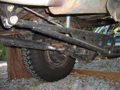

Also thinking of incorporating a traction bar. Sort of along these lines. I like the dual bar and the shackle mount and if I mount it to my block it should work tickity boo.
Control spring wrap and wheel hop.
I'll be cutting my shock mounts off and rewelding them higher on the diff so I can keep stock shocks.

I'm picking up what your laying down. But this truck isn't going to need that much wheel travel.
1/4 elliptical would be nice but not needed.
Plus I have air bags and I do not want to modify to keep them. Easy enough to do but I don't wanna.
Probably don't need torque arms either. But the occasional pulling or muddy roads, I just don't want spring wrap.
