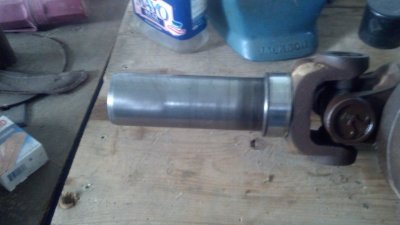

I have a 2005 dodge 2500 with a 3 piece rear drive shaft. The stub shaft that goes into the transfer case has what i would call a harmonic balancer on it. I was recently told that i should get that looked at before it took out my transfer case and i can't find one to replace it. Most of the places I've talked to have no clue what i'm talking about. Any advice?

i can get some pics later today. i wasn't having any problems with it but i really didn't wanna have to replace the transfer case after just replacing the transmission.

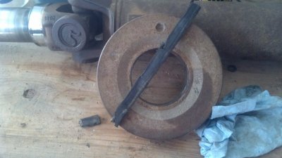

that rubber piece is supposed to be inside the balancer and hold it on the stub shaft... and i thought where each u joint was was a seperate piece and i was informed differently, so its only a 2 piece shaft
