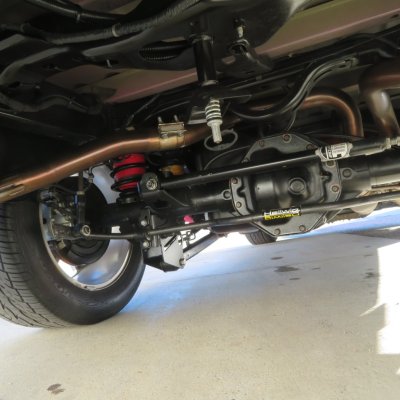

I ran 305/50's on the factory 9" wide Sport rims with no issues,and i think your rims are also 9" wide.They cleared everything underneath with no problem,but if you go for them,crawl underneath and make sure you have clearance around the brake lines and abs sensor wiring.The brake lines can be tweaked slightly if need be
