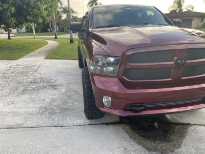

I’m running 18x9 -12 with 305/70 and no rub. I’m on 3” lift
Edit just realized you said a +12 offset. Given factory is a +19 id be guessing you’d rub. The +1 offset is probably 1/4 clearance from rubbing. Remember lower number means more out.
