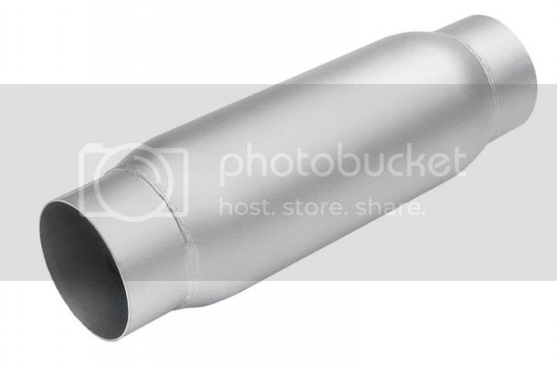

I ran a Dynomax Race Bullet on mine...got a video if ya wanna hear it. Ran the exhaust open behind the muffler, no turndowns nothing. Never even a hint of drone or cackeling.

If I recall correctly, the one I bought was the 16 inch bullet...snagged it on Amazon for less than $38

What did you do again .. just add the bullet .. left the stock cat ?

Yep...sawzalled off the old muffler, muffler clamped the race bullet on and rode out. I was also running the 14x3 air cleaner with a K&N filter rather than the stock ****** air box.

What was the size you went with ID/OD

I'm running the same muffler on mine. 2.5" inlet/outlet and dumped right before the rear axle

I know mine likes back pressure. When I got it, I replaces the rusted out factory muffler with a FM Super 44 and it ran the same, just louder.
Swapped that one out for the dynomax and felt a pretty good increase in the low end and it seemed to smooth out the idle a little
