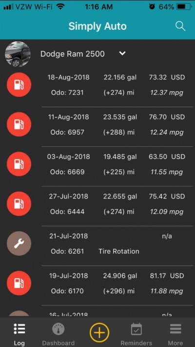

I believe after I had my recalls it's fixed issue with reading fuel levels. I drive about 25 miles a day, and would fill up about every 6 days I'd have around an 1/8-1/4 tank. I'm now on day 10 of my first fill up after I had the recalls done and am just below a 1/4 of a tank. (2018 2500 6.4L ~ 7500 miles 2" level 35's)
1500ram12
Jan 23, 2012
5,487
2,432
2005
5.9L Cummins
After filling up last night when my gas Guage read just above empty but still only took about 24 gallons
