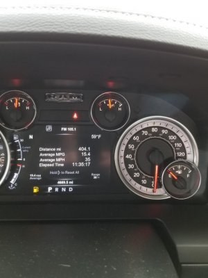

Update: I drove until the low fuel light came on and then I headed to the gas station. It came on with the Range saying 45 miles. I put 26.87 gallons in the tank and the range said 38 miles when I stopped. So, about 5 gallons left. Minus out a 2.5 gallons or so for 38 more miles and I theoretically would have had around 2.5 gallons at empty. I think that's probably close enough to call the fix a success. It's a lot more accurate than it used to be. So, for me, replacing the fuel level sending unit seems to have worked. Side note: I have about 220 of freeway miles on this tank where my mpg was about 17.5, I don't typically get 15 mpg around town...

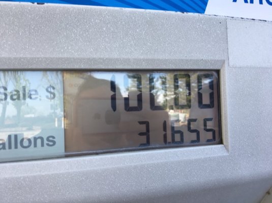

Have a 2016 with 32 tank. I let it run to zero then maybe another 50 miles. I then tried to start my truck and it wouldn’t. I guess the low fuel mixed with my sloped driveway was too much to overcome. I put in about 1/2 gallon from my gas can and rolled down my driveway in neutral. I then had enough gas to get down the road to fill it up.
I can’t say for certain if there was more room in the tank because Arco stops automatically at $100. Didn’t know. Still put in 31.6 gallons.
My point is this...
Yeah I have a 32 gallon tank. I know I can squeeze a little more distance once the needle hits E. But, I would hate to run out or experience the inability to start because of a slope. So, I’ll just drive as is. No update necessary for me. I’ll treat it more like having a reserve tank or a gas can onboard without having to actually have a gas can! [emoji106]
$100 for a fill-up !!!!! Dam, your paying way too much for gas !!!!

And that’s 87 octane :/
Yay for California
