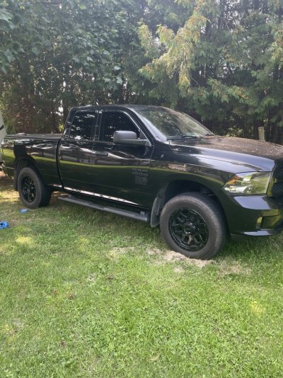

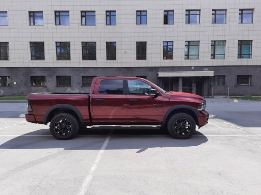

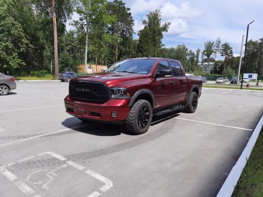

So i've installed a Rough Country 2.5" leveling kit (spacers) on the front of my 2011 ram. Now i'm looking into the biggest tires I can fit. I am thinking 33" but If i can push into 35's, why not? hehe
I am looking at BF Goodrich KO2's (hopefully 35 inches max?) My truck currently has 17" FRD HD Series FRD-TR2-black rims/wheels. It seems that there are 35 inch tires available for said rim, but I would like some input as to what you guys think?
Would spacers be needed if i put 35 inch tires? I am looking into a lift kit, but currently, I don't have the budget for it. That's in about a 1-2 year plan. So right now, the plan is to get it to look "meaner" for the meantime. Any help would be much appreciated. Thanks guys!
Just for information, I have a 2019 1500 Classic and I put the same levelling kit in the front, and I put 12.5/35R20 on my truck and have no clearance issues. Mine has the factory 20" black wheels with no spacers. I have the Ram moulded mud flaps on it also, and the tires don't rub on them either. I se some people suggesting 33's because they look better - I guess I am old school- the more tire sidewall the better. I hate the look of even my tires because of the 20 inch wheels - 35 inch tires that have only a bit of sidewall because the wheels are 20's. I like the look of what I have always liked - 15" wheels with 35's, then you have some tire. That is just my opinion, and I am like you - if I had lots of money I would lift my truck and install 37's or 40's - but it isn't in the budget. 35's with a levelling kit fit no problem on mine. Hope this helps, and thanks for listening.

My 2019 1500 Classic with just a levelling kit in the front handles 12.5/35R20's with no problem. I didn't put anything in the rear for lift, just the front levelling kit. I have been in some pretty sloppy spots, and even going angle through big holes, and even with the Ram moulded mud flaps it doesn't rub at all. Full lock to lock and they don't hit. To me the more sidewall the better, and 35's aren't "overstuffed" in the wheel wells at all.
