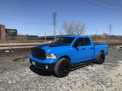

33-35" tires work depending on tire width and/or wheel offset with a level up front.
I went with 275/65/R20 (according to Cooper 34.1") on the OEM rims (20x8) and I can easily go to a 35" tire up front. I am leveled with Bilstein 5100 shocks set a the highest level at 2.8".

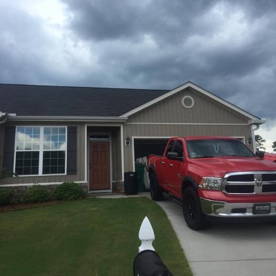

My truck is leveled, stock 20's w/33's Nitto Trail Grapplers. Love the look, sits about 2" overall higher than my uncles stock ram. It does slightly rub when reversing (full lock)
Pic was the other day please forgive the dirty truck
not sure the picture matches the description. 275/65 is a 34" and it doesn't look leveled at all. maybe its just me. looks good though.

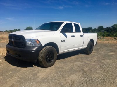

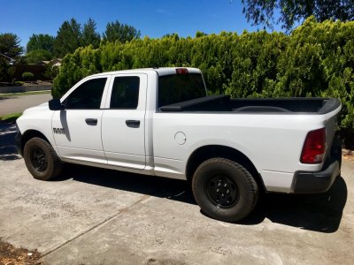

I have 35x12.5x18s General Grabber X3s on 18x9s Badlands with 12mm offset and clear just fine no rubbing.
Not a fan of 20" rims and lifted trucks and would have bought 17s but these wheels did not come in that size. I like more sidewall on offroad tires.
Is that a negative offset so the wheels come off a bit? It looks nice..

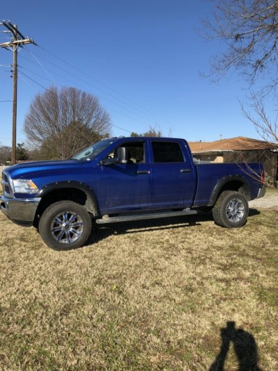

RC 2.5 leveling kit and 35-12.5/20 Nitto Terra Grappler G2’s RBP wheels
I love my truck!

Can you get 37” tires under the 2500 ? Looks like you can....I just bought an 18 2500 the other day. I’m thinking about getting a 5 1/2 lift for it. Nice truck though.
