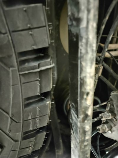

I recently saw someone post a modification to their heatshield so they could mount a 35" spare. I for the life of me can not find it. I got a Toyo 35 R/T spare mounted and it is not going in. thanks in advance.

Well its hitting on the driver side frame, receiver hitch and track bar lol.

Without pushing up the railing and the hitch wire harnesses out of the way there's no way that my 35" C/T tire would have fit.

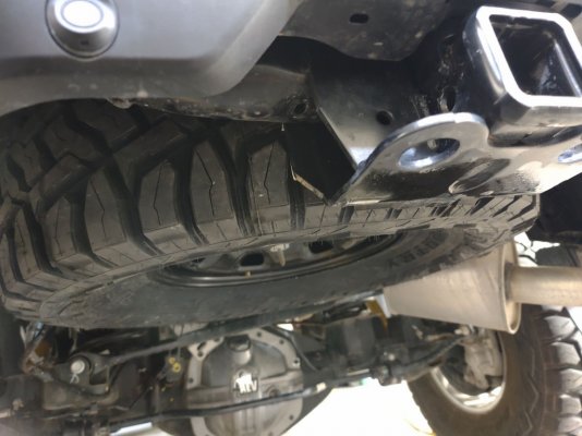

Victory. I pulled the valve stem core and sprayed fluid film on part of the tire and got it up there. once in place put a about 20psi back in.

My 35x12.50x20 Nitto had to go in the bed, locked by a cable, under the tonneau. Itd hit trackbar, and just was too large.

FWIW, my 35" Toyo C/T fit in my spare location without any issues at 40 psi.
Could be that they run a bit smaller, could be that my spare tire location had a bit more clearance than others. Who knows.
Either way, I spit on it, it went in easy and felt great doing it. Wait what.
