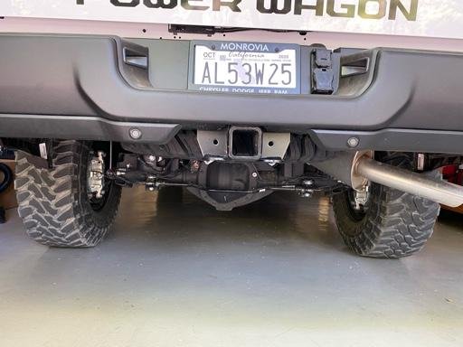

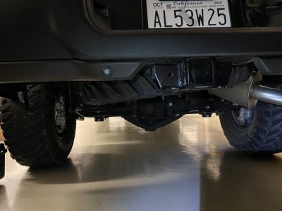

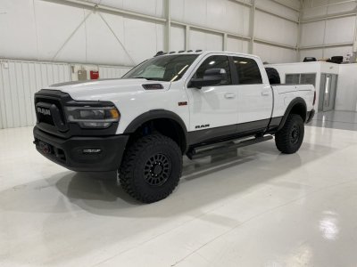

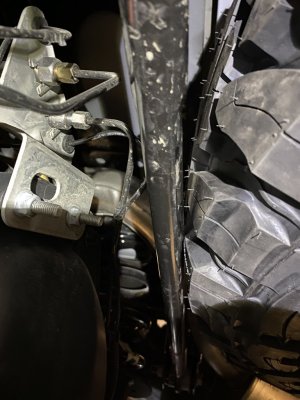

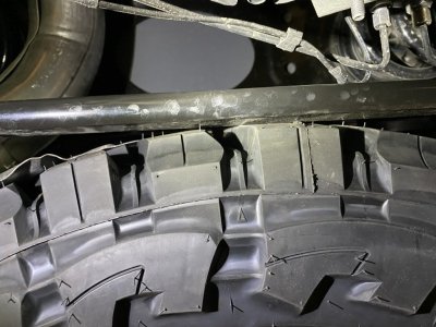

Hey guys,
Wanted to share some photos of my 2020 Power Wagon with 35" Toyo MTs. I had read reports that the 35" fits "easily" in the spare well. Honestly it was quite a chore to get it in at the perfect angle and it touches the panhard bar. It also doesn't sit level sits the driver side frame rail doesn't clear. This is with all but a couple PSI of air removed. Is this acceptable?

I have 35 inch Falkens and my spare barely fits also. I’ve been running with it touching the heat shield slightly for a couple months with absolutely no problems. Dropped it down and inspected it the other day. It’s was fine.

It's a tight fit to be sure. I'm running the Saltas with Toyo CTs. I'm not touching anything in the tread area, but it's frog hair close. Probably spent a good hour cussing, finessing it in with another on the crank. it's flush against the back plate and practically deflated though.
I've looked at alternatives for stowing the spare, but all come up short.

When I used to carry 35's in the factory location, I'd deflate to like 10psi. I have onboard air though, so it wasn't such a big deal.
On the upside, they will fit easily, when they're worn out.

I'd be concerned with the track bar rubbing. Is it possible to use a ratchet strap that you could run through the wheel and around the hitch to pull it towards the rear of the truck? I did that on one of my trucks years back to clear a large rear diff cover. I know your touching the hitch but a little tire compression against the hitch may get you some track bar clearance.

Also, I wonder if running a different track bar would help. Maybe you could call Thuren and ask them if their track bar gains any clearance.

I thought about that but the rear brake distribution block is extremely close to the other side of the bar. Honestly...after sleeping on it...I'm thinking that it shouldn't be down there. The hassle of getting it in or out is not something I think I want to deal with when actually on the trail. My ultimate plan is to get a RAM Box compatible Nuthouse Industries rack and store it on their platform system. For now it'll go in the bed strapped to the factory rail system. I think the 35"s that people are getting away with down there must be smaller than a true 35" like the Toyo MTs are???

Love the truck and the look. But you know if you gotta ask it's too close. I'd get it handled before it gets ugly. Very nice truck...

It actually clears by a decent margin now. You just have to hammer it up there. The sidewalls are extremely stiff on this tire so just airing it down doesn't really get it to conform that much.
