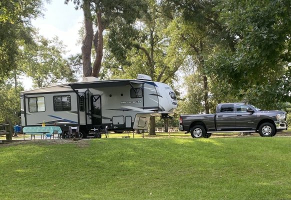

Jbinramona
Nov 16, 2019
42
45
Ramona
Cummins 6.7
2016 Ram3500 4WD 6.7 Cummins Aisin Transmission 4.10 rear diff. Upgraded 19.5" wheels and G rated tires.
29,000 going down the road.
I have held a Class A license since 1997, so am not afraid of weight, I know how to tow (LOL). This setup tows like it's not even there. My wife even drives it occasionally.
Call me crazy, but it works for us.View attachment 481357
Okay... I am calling you crazy! :Insane:Was it hard getting used to having that thing on the roof of your truck? I think I would be afraid of even loading that thing up on the roof much less hauling it down the road. It is a very nice rig though!:happy107:
