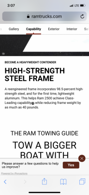

Interesting. I didn’t think they modified the frame on the 2019 HDs.
According to all of the literature I have read, the frame is completely new.
magazines often times get it completely wrong. seeing it first hand, the frame looks almost identical. maybe theres some miniscule differences but it certainly doesnt look all new to me
I’m sure there’s some tweaks to it as well besides just the materials.
Agreed. Im just stating they claimed it was all new.
The old suspension appears to be plug and play, so they couldnt have changed it too much lol.
