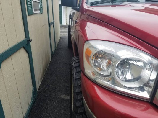

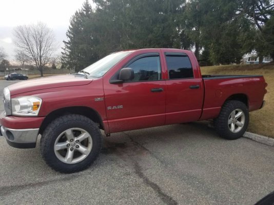

Alright, here's a couple quick pictures from work. It's still dirty though. 8228c30ba9ce7edc9d373bcf3388f5a4.jpg0c3b1caa59c509b74e5cc91786e4dc26.jpg92b1600137b040521a0f157c78332a29.jpg
I'm in the market for new wheels now. I'm not sure on 20x9 or 20x10. I like the deeper lip, but I'm afraid the tires will look too thin on a 10".
Any idea on what backpacking on a 10"? If I go 9", I'll do -12, since that's technically where I'm at now with the 1.25"spacers.

if you get 20x10's to have the bigger lip that would mean getting -24 mm offset. You will having rubbing issues when turning because the wheel will stick out an inch further

I already trimmed quite a bit of the plastic to fit the tires now. But if it's going to be a major problem, I'll just stick with the 9".

Yea I think you'll be looking at metal trimming with the 20x10's not just plastic liner
