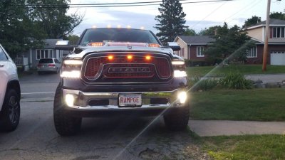

I also graduated in tire sizes from stock, to 33s and from the 33s right to the 37s definitely a bit of a difference in the feel, the ride and the gas millage, BUT" for the look and the lift? its all worth it to me. 37s on a 4 inch superlift.IMG_20190628_203524.jpg IMG_20190701_134150.jpg IMG_20190710_060629.jpg
