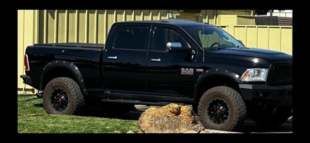

Looks good fred!
But…there is no way that has a 6” lift. It would be ridiculously skying 37’s if it did.

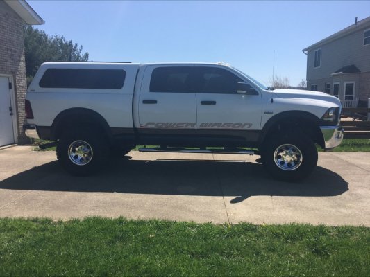

I put Toyo 37x13.50r17 m/t tires on my 2015 2500 6.4 power wagon and it has a 4” lift and a 2” leveling kit but had to grand the ends off the bottom of the weel well and no rubbing on suspension as I was told it mite do ….View attachment 521319
Looks good, but agree about the lift. This is mine with 37x13.50R17 tires and only a 1.5" Thuren lift on the front and 1" spacers on the rear.

Yea but our trucks come from the factory with a 3” lift mine is only 1:12 more
1.5” up to ‘18…’19+ have closer to 2”.
So yea…that looks more like 1.5” lift with 37’s to me. I was gonna say, a 6” lift on a power wagon is ridiculous.

As already posted, a '15 or '16 PW (the OP and mine shown above) are about 1.5" higher than a regular Ram 2500. Mine is lifted 1.5" higher in addition to the factory 1.5" lift, so around 3" total lift over a regular 2500. The point to the replies is that the truck in the OP definitely does not appear to be anywhere close to a 6" lift over a stock PW (which would be almost 8" of lift on a regular 2500), and not even a 6" lift compared to a regular 2500.
On mine, again with 1.5" Thuren springs over a stock PW, and 37x13.50's required a decent amount of trimming on the front to clear when turning. That is also with rims with far from optimum backspacing for clearance.
