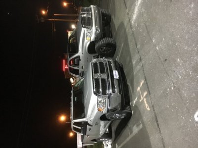

My new 2016 3500 6.4L Hemi next to my old 02 (10" lift on 37x13.5s with 2" spacers)...sorry bout sideways pic- it wasnt sideways when uploaded.
When I look at the two rigs side by side I think 8" on 37s might be best. To get 38x15.5s on comfortably Im thinking an additional 3" body lift on top of the 5.5" susp + 2.5" level is a must.
