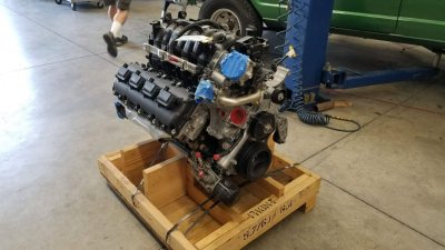

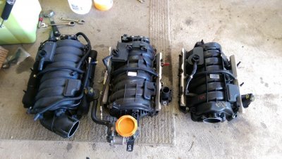

Ok...yes, truck engine vs hp car engine. While true the heads aren't the exact same spec-wise, they are the exact same design/architecture; externally every hemi engine within it's family is externally identical (03-08 5.7/06-10 6.1, 6.2's being the odd man out). As for valve covers (which the part referenced above is not), all 09+ 5.7 and 12+ 392's use the exact same double hump valve (for valve clearance) cover and are interchangeable (all 03-08 valve covers are physically interchangeable but need will vary on which ignition system is in place). Production wise only the 6.2's are different. The coil covers will fit, however they are only a straight bolt on to car and suv 392's. Other engines require trimming to fit. I had a set on my Charger:
They will pop right on to eagle car and truck engines because they all use the same fuel rails with the same spots for the support pieces and are all somewhat similarly shaped. How do I know this? Because I have one of each lol. This is what they look like put up to a 5.7 eagle truck manifold (someone a while back asked me for comparison pics):
They are all quite similar, with the truck manifold and the 392 manifold being the most similar and both superior to the stock eagle car intake being they are active intakes.
With the truck 6.4 being identical EXTERNALLY (yes yes, internal differences aplenty, we know) with the exception of the active intake IT has and the fact that it kicks off to the passenger side:
It basically looks like the others, same fuel rails. With trimming, these coil covers will fit right on. You even have a choice, you can get 392 ones or 6.4 ones, both are available.

Can you tell us which manifold is which in this photo? Thanks.
JB1
Nov 3, 2011
8,366
7,542
Houston, Texas
My guess:
Left is 6.4 car engine
Middle is 6.4 truck engine
Right is 5.7 car engine
McBroom
May 25, 2017
5,860
7,404
Denison Tx
Hemi 6.4L
My guess:
I don’t think the middle one is the HD truck intake. I say this because my intake and throttle body is at an angle (looking from the front of the engine) it is at like a 45* angle to the passenger side.
Blue Streak Pearl off-road
Hey I said it was a guess lol
Maybe the middle is the 5.7 truck then lol

Looking closely at the photo, the obvious large yellow writing marked on the right intake clearly states, "5.7 Hemi". I've fallen for this before, my guess that it's really a 6.4 Hemi truck intake disguised as a 5.7. The other two are for something else.

imag3215-jpg.146427
My guess:
You guys are killing me...I even put a pic of a truck 6.4 in that post LMAO
Car 6.4/392, truck eagle 5.7, car eagle 5.7
