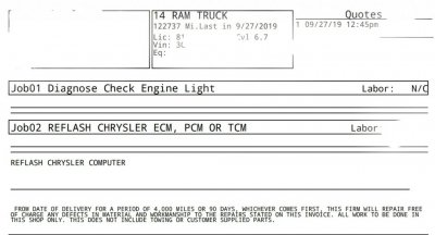

The images are the receipts of work done. The shift cable was also done but can't find the paperwork on it.
