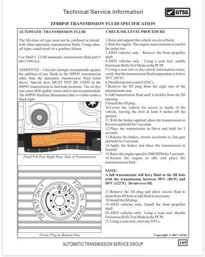

From the ZF service manual at:
It does not specify the pan mating surface be level, but OTOH most vehicles other than RAM and Jeep have the trans sitting pretty level in the car. So as mentioned earlier, outreach to ZF technical support or engineering is likely the only authoritative source that would be respected in, say, a lawsuit over an improperly serviced transmission.

Now that the green sheet was brought to our attention, especially since the story went something like it was included with a new replacement Ram transmission from the dealer/manufacturer, make sense? If the transmission was sitting on a conveyor belt and awaiting its first fresh factory fill, wouldn’t it be level? The exaggerated rake of the transmission in the Ram truck must have necessitated the green sheet. It was certainly put on good go green paper instead of regular white paper to bring attention to the sheet.

Step #10 does say to have the tires in the air 8",which comes pretty close to leveling the transmission.

Wish that manual stated it was good for 8HP70. Only says 45 and 55
