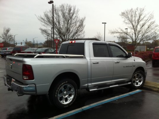

Before pic. Still waiting on the shop to call.
It was just a little too much like my Durango with the front tires all stuffed up in there and the massive space in the rear. I know that with a load it evens out, but I don't haul gravel or tow much, so like the OP, it's mostly for looks. [emoji41]

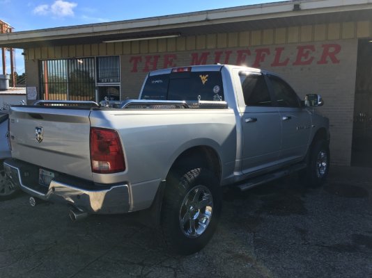

Got her back today. Went ahead and pulled the trigger on some 37x12.5R20 Nitto Terra Grappler ATs. Kept the stock 20x9 chrome-clad 6 spoke wheels, and I'm glad I did. Saved a ton of money on wheels and: The truck looks awesome! I'll post pics when I get daylight back. Ride is super smooth and no rubbing at full lock left and right. Honestly came out a little higher than I was really expecting.

The front came up to 37 3/4", the back to 38 1/2". That's up from 31 1/4" and 34", respectively. So a total of 6.5" in the front and 4.5" in the back. Kept a little, almost unnoticeable rake, which I like. Those measurements are taken from the bottom of the wheel to the fender, FYI. For total lift, yeah, you would add the 2" for the difference in tire size. Pictures still in the works.
