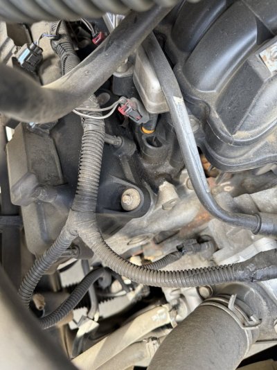

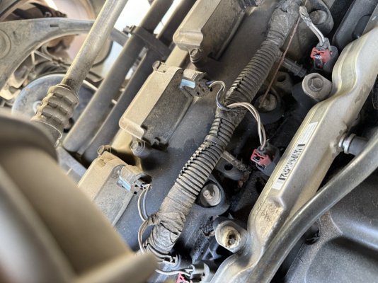

Current 5.7. Oil is coming out around cylinders 2&4. When I get back to the house I will be able to try zeroing down on the issue. No oil on the ground, just between the passenger side head and block. You can see the moisture and where it ends.
Did you install the gaskets correctly,they are side specific,and if you get them backasswards,you'll have an oil leak exactly where you have a leak.
