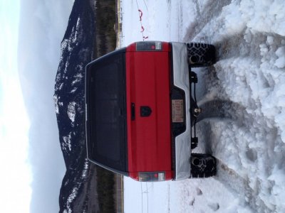

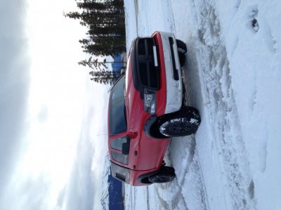

Hey guys just got my 4 inch Rancho lift kit installed. Love the way it turned out. Rides like a dream. Now I am wanting to add a set of Bilstein 5100s to level the truck. What do you guys recommend I set them at to give me a level ride height? Thanks in advance.

Sorry about the rotated pictures. Not sure how to change that lol

Nice truck dude looks great, looks almost level by the pics. I notice most guys either go 1.4 setting or 2.1 with their lifts. You could always measure to see how much you need and gauge by that. Hopefully someon with this setup will chime in soon, I know there lots out there.

Personally I like a bit of rake. I've got a 1" rake on my truck. You can hardly tell but when you load something in the bed (heavy like an atv) the truck sits perfectly level.

Truck looks good with the lift. Seems almost level in the pics to me. I would just measure it on any flat ground to the center of the wheel well front and rear. Your truck actually looks more level than mine and I have less than 1" of rake.

Thanks for the compliments guys! I love the way it rides now! And the pictures dont do it justice. There is still a pretty good rake going on. I want the truck to sit perfectly level because I don't tow that often. And I want to do airbags in the rear eventually anyways
