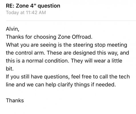

After getting a better look at the pictures, it looks like the corner of the stearing stop on the knuckle is contacting the stearing stop on the a-arm. It should which is causing the v notched wear. The stock a-arm is cut out to provide clearance. The other lift kits could be the same way. Like I said, I would contact zone to see what they say. Until then, I wouldn't max out the steering when making turns.

I agree. Any of the kits will probably be the same way. I am not trying to talk anybody out of this wonderful kit, I'm just trying to see if anybody else has noticed this, and what their's looks like. I have contacted them through email and am waiting for a response.

Thanks for sharing this. They have yet to get back to me.
