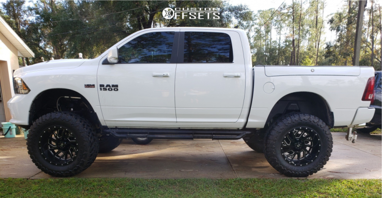

Here you go buddy ....
Wheels - RBP 65r - Black Milled
Front: 22x12
Offset: -44
Backspacing: 6.5
Stance: Aggressive > 1" outside fender
Rear: 22x12
Offset: -44
Backspacing: 6.5
Tires
Toyo Open Country Mt
40"x15.5"
395/60 40"x15.5"
395/60
Suspension
: Suspension Lift 7.5" & Body 3"
Suspension Details: Fts 8in with coil over conversion
Suspension Brand: Full Throttle Suspension
Rubbing: No rubbing or scrubbing
Trimming: Minor Plastic Trimming
Front Wheel Spacers: None
Rear Wheel Spacers: None

That truck looks badass!
Nov 20, 2018
77
Riverside California
2018 2wd
HEMI 5.7 Revolution 4.88s
Oh it does lol ... that's what I plan on doing to mine eventually ... these trucks look like beasts with anything 37 and up and 7" lift and up ... but this one is BEAST !!
