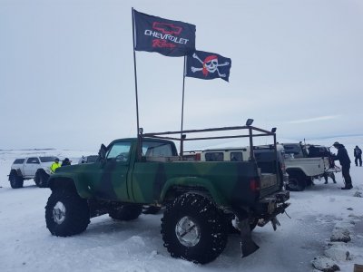

what's the air pressure in those 49's and 44's out of curiosity? do you use an onboard compressor to raise and lower the pressure as needed?
About 25 psi on road, 8 to 12 psi off road and down to 2-4 psi on snow. I have an onboard compressor and a bluetooth controlled valve system to inflate and deflate while driving.
See the airlines going to each tire.

What system are you running for air? Have a link?

It is from a friend of mine, an engeneer. He designed the bluetooth controlled valve system. The compressor is an of the shelf Fini. Really simple setup.
Here is a link to another company that sells a similar system
http://www.styri.is/vorur/urhleypibunadur/
I don't think there is a system here in the states where you can run an Aggie line to each tire.

Do you think there is demand for it in the states? Sourcing it from here would not be a problem.
Here is a picture of a typical wheel with such a system:
There is a small faucet on the rim that you keep closed in normal driving. Then when you are on snow you attach the airlines between a fitting on the fender and the wheel and open the faucet and you are good to go.

Oh there most definitely is. Especially for rock crawlers. I definitely want one. Got a link to that system? I'll definitely buy one
