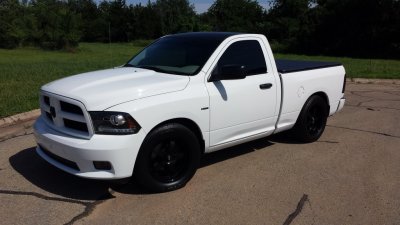

If I didn't need the space, Id love to have my 2011 RCSB back...
