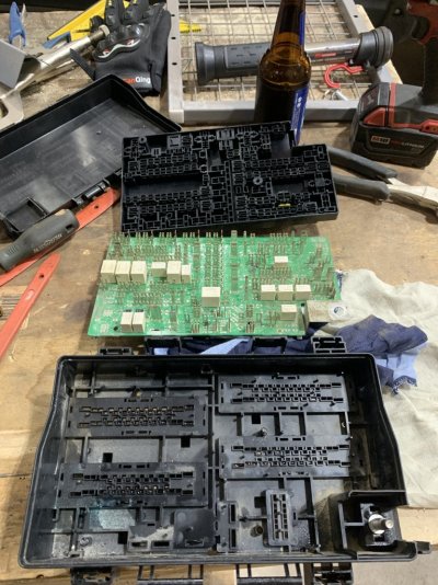

With the experience of my last truck I dived right into the Tipm. Nothing found there either. Practically new.
Either way I cleaned it all with contact cleaner and reinstalled.
