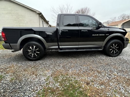

It snowed like crazy today. The roads froze over and another layer of snow landed on top. So naturally, I put my truck into 4WD before leaving. This seemed to be a horrible idea.
I just bought this truck a few weeks ago and haven’t tried the 4WD until now. When I put it in “4WD Lock” my entire truck jars and shakes HARD, so hard it’s audible and everything bounces around inside. This happens at 20mph and up. When I put it in “4WD Low” the same happens but at 10mph and up. When I got off the snowy road and tried again, it was fine.
As far as I’m aware. There’s no other issues with the vehicle. It’s ran fine since I got it. Any suggestions? Tips?

If you are not driving in a straight line on hard road you do not want 4wd on or it’ll bind and buck and can break things. Any turning will bind the drivetrain if you have traction. Even off-road with traction will still cause binding in 4wd. 4wd is only designed to be used in low traction scenarios. If you had 4wd auto you would have been fine. Only other thing I could think of would be a bad cv binding and popping but you should be able to feel a vibration from that under normal everyday driving and I wouldn’t expect it to bounce the truck around. Also what leveling kit was used. Please share pictures of the front struts and at the top where the strut mounts.
