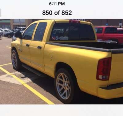

CorDog009
CorDog009
Mar 15, 2014
340
82
East Texas
2005
Seems like it did. This is the only pic I have at the moment on my phone.
Redtruck-VA
Jun 29, 2010
5,864
985
Virginia
2003 & 1989 D250 RWD
Hemi-5.7, 5.9 12v & 24v diesel
Looks good, you have the hard part done with the 4x4, easy enough to drop the rear to whatever you want.
