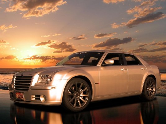

If you see me driving this, have fun trying to pass me... :D

Tell you what, I'll race ya for big money if I can choose the road. :) After that you may need more then an alignment. But I will admit it looks very fast.

LOL...yeah, it's fast. It's all aligned and ready to go.

Maybe beat me silly off the line, but after the 10th or 20th pot hole I may get the advantage. Have to tell you though I've always like the styling of that model and if I didn't have the RAM I could see me in that as a daily driver.
