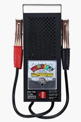

I would load test the battery as a first effort.
It has a high probability rate of creating this condition and is almost the least amount of effort to test. Most auto parts stores will load test for no cost.
And don't think that because you replaced your battery last month, it could be exempt from having a bad cell, that's not how these things work. :cool:
I bought my own analogue load tester because they're inexpensive and nice to have in the toolbox. BTW, the analogue beat the digital version as far as being consistently accurate.
