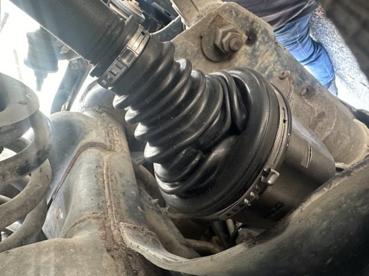

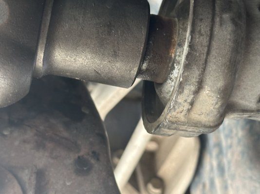

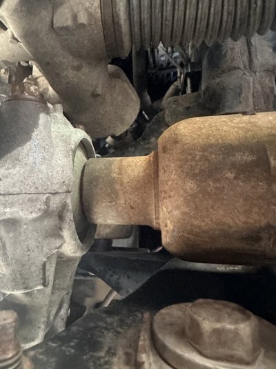

So It’s done, and I have another question, is the CV still not tight? They put a new one on along with the diff.There is a gap compared to the other side? Also the boot appears tight and twisted? Sorry for so many posts but I don’t have anyone to ask. My family member is an employee at the dealer in question and it’s tricky to rock the boat to much..
