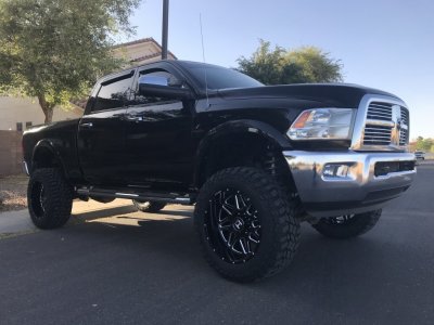

I did a lot of research and had a hard time finding what was possible with the 5” RC lift so I thought I would try to save someone else the grief. I have a 5” RC lift with 1” day star coil spacer and was able to fit 22x12 wheels with -44 backspace wrapped in 37x13.5r22 Cooper tires. With minor trimming of the inner fender I Barely rub at full turn

Wow looks great!!!!! Awesome job man
