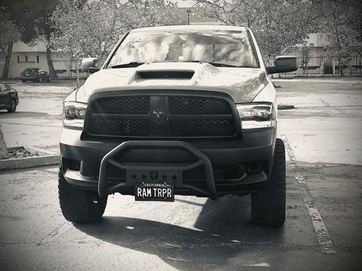

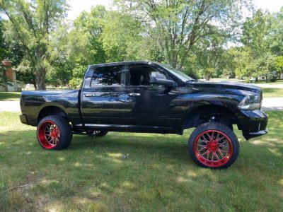

I’m currently running 305/70/18 which is very close to 35’s. I am going to go with 35x12.5R18 because if I do 37’s I can’t fit in my garage anymore. I also have 4.56 gears and with 35’s if feels awesome.
I can some more shots when I get home. I am going to stick with true 35x12.50R18 for one more round of tires :)

Bigram truck looks sick from the front. If you have any side shots that would be great. I have 3.92 gears and do not plan on upgrading so I’m thinking my best bet would be to stick with 35’s. The look of 37’s is just sick

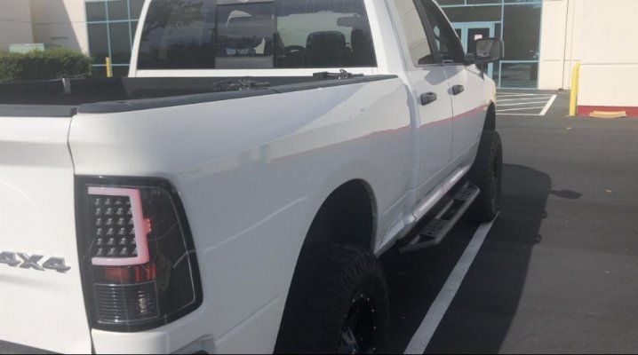

Here are some shots. Hope they help.

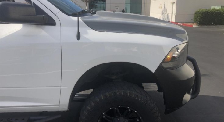

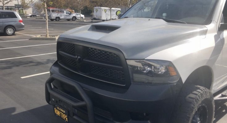

6”lift? Any trimming on the bumper?
I want 37’s but don’t want to add body lift. That’s mean more suspension parts. Not wanting to do that unless I have too.

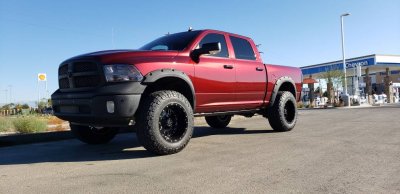

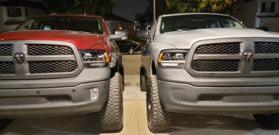

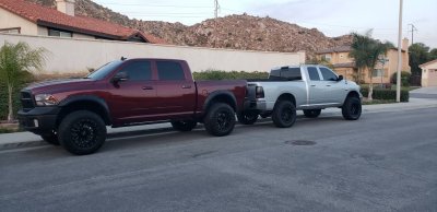

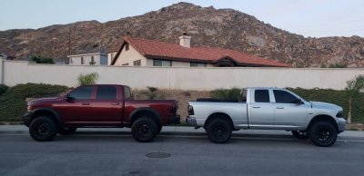

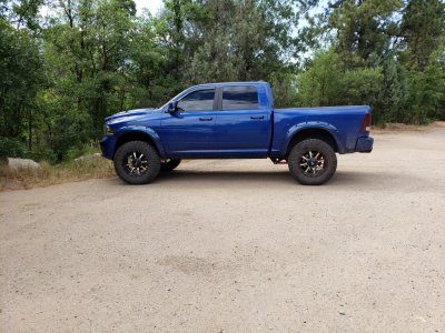

35s look just fine on a 7" lift as you can see below on my buddies Ram on the right .... on a 6" lift they definitely look right .... 20200623_200400.jpg20200926_214747.jpg20200623_200414.jpg

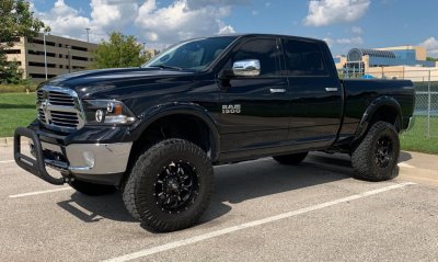

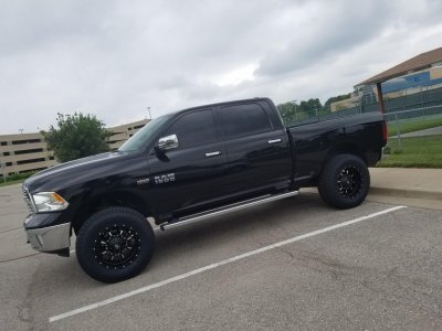

Here's a pic when I put the 6 inch lift on with 37's. Those are 37x12.50x20 Nitto G2's.
The second pic is when I added the 3 inch body lift and put 38x13.50x20 Nitto Ridge Grapplers on.

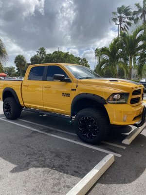

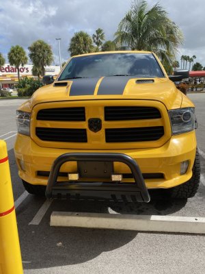

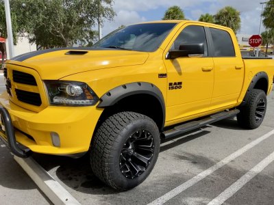

I recently did an "upgrade" to what I had before ( 2016 1500 LoneStar Crew Cab 2WD) Got stuck in the mud at 1:00 am with the whole family and decided that I would never would go through the same again, and decided to look for a 4WD, luckily enough I found the exact same car but in the Sport trim, with pretty much everything I wanted to do to the previous truck. As far as I know, mine has a 6" RC lift, on 35x12.5xR20LT Nitto Terra Grapplers G2 on what I think might be FUEL wheels (don't know the model yet) attaching pictures. I do not have any rubs anywhere, I can do my turns OK.IMG_1690.jpeg IMG_1691.jpeg IMG_1692.jpeg

Nice man ... those are Fuel Assaults, I was actually going to go with those wheels but decided on the RBP 87R Blades instead with Nitto Ridge Grapplers ...

Yes. You will have to cut the sport bumper till the tires clear. Dremel and assorted cutting tools work nicely. A lot easier than a body lift to boot.
