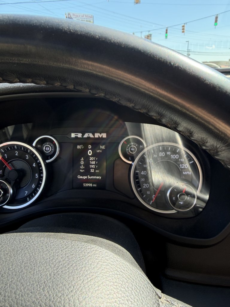

Oil temp on mine is pretty much the same as the coolant temps. This was just driving to town no trailer attached.
normal temps
