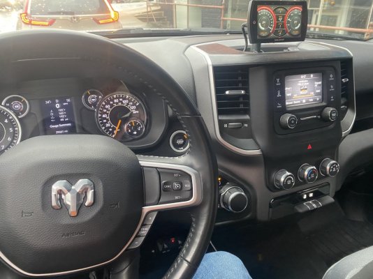

My tuner turned my cat efficiency codes off for my old Express and my current Lone star. You just have to whisper sweet nothings into their ear.
