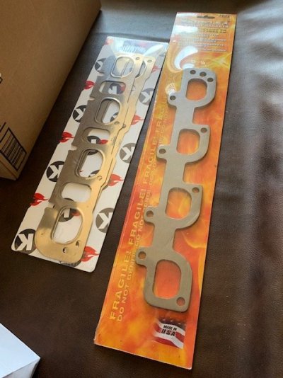

The Remflex gaskets showed up today. Wow, those are different from the others. Nice and thick.

I ordered the same gaskets, should be here Monday. Glad to hear they’re still made of quality material.
They're a graphite gasket Austin,totally differant then what you think a normal gasket should look like.They'll also make your hands a bit grimy,lol. Do not bend them,as they'll break if you flex them to far.
I’m glad you said something, I’d had sent them back you’re the one who sold me on them, can’t wait to see these things.

Here are some images to show the difference between the Kooks and the RemFlex gaskets.
