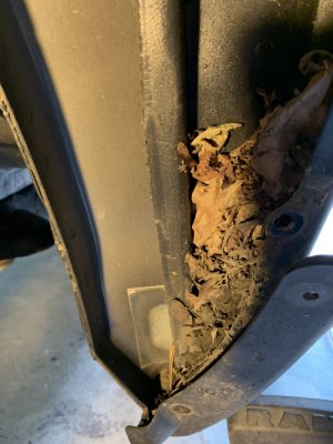

As a side bonus, I was able to address this compost pile that had built up over the last 100k miles. Vacumed, cleaned it up a bit and then drowned it in Krown rust preventative spray.

Nice writeup & pics. Especially the compost pic, sounds like we should pull the wheel well liners every year to clean that out and avoid rusting.
Oddly enough this was the case for the drivers side not the passengers. There was enough dirt build-up on the passenger side to justify the process of pulling back enough of the liner to get at them but nothing like the drivers side.
